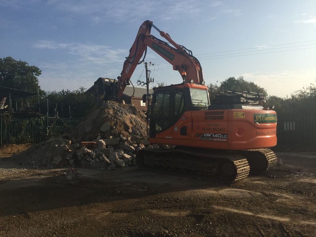

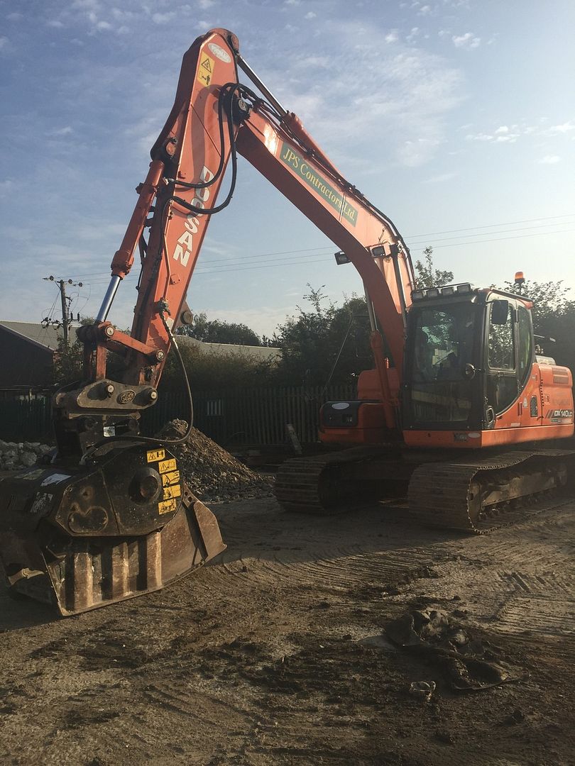

Started crushing this morning but the belt tensioner gave up on the bucket so an early day for me.

That belt must take some abuse

I'd say so and still seems in good condition, ordered a new tensioner today so should be back together tomorrow.

My only problem with the crusher bucket is greasing ,it can be a real pain getting the nozzle on bad design but other wise great tool changed the grease fittings on ours to button type makes life a bit easier

Could you not fit some remote protected piping and a new fitting position, muck ?

That's all I did with mine, brought the 4 of them up to either side of the headstock. Used to be a annoying having to take the side panels off to get in to do it. Was only a problem on the smaller buckets, more room with the 900/1200. Think I've got some pics somewhere.

Muckman know what your saying there a pane to get to, Trax/Ollie thats a great idea will look into that, on the new one's there at the front and easily accessible.

Well i had thought of piping it but button nipples was quicker to fit and it worked out a lot better than i thought, but why didnt they do it at the factory i guess they want you to not grease it then buy parts
