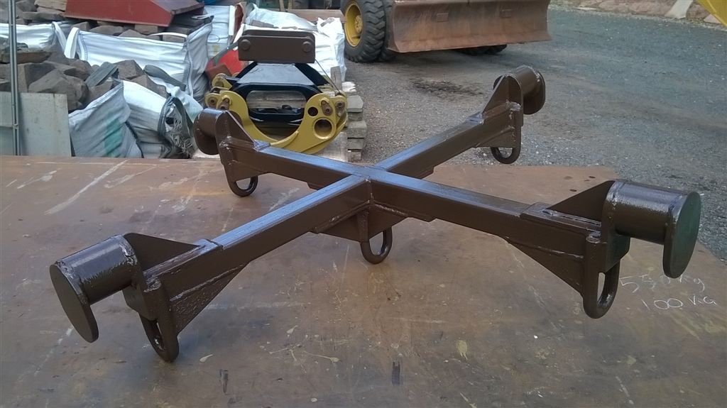

Bag lifter got a 'flight' back to ....
.... its usual home ... from the bench, as I needed the space ...
to park this on whilst it got cleaned and tarted

'fore getting parked with t'other gear,
so's I could take the head off it for some boss welding and cleaning, 'fore it too gets a coat of shinier tish
